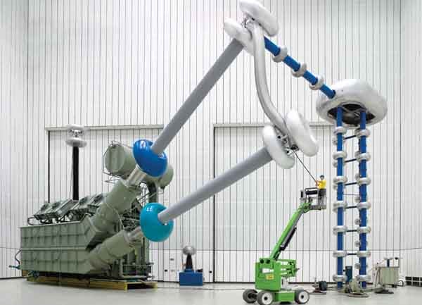

5.     Supergrid transformer.
In the next three decades, China plans to build several giant hydropower plants in its southwest region, where abundant hydropower resources are located. In order to get power from these plants to rapidly growing industrial cities like Shenzhen and Guangzhou in the country’s southeast, China is building a long-distance, ultra-high-voltage direct current transmission line that operates at 800 kV—a world record. Siemens Energy will supply the 10 800-kV transformers (shown here) to that project as well as ten 600-kV transformers by May 2010. Courtesy: Siemens Energy

Increasing the voltage rating from previously used 500 kV to 800 kV represented a 60% increase — an unequaled rise in voltage level — and it wasn’t easy, Siemens says. Developing the 800-kV UHVDC transformer was a major milestone because it meant overcoming the key challenge of controlling external and internal insulation requirements. In the UHV range, some insulation characteristics become highly nonlinear. For example, the distance in air clearance required between HV parts and ground can be approximately 4 m to 5 m for 500-kV HVDC systems. For 800-kV systems, however, the 60% increase in voltage level meant that the necessary air clearance nearly doubled.
To achieve this clearance, the most straightforward approach would have been to increase the size of components and the distance between components so as to achieve sufficient insulation strength. But this would have resulted in an extremely large design, and the equipment in many instances would no longer be feasible to produce or transport. The selected approach was therefore to redesign all main equipment exposed to the 800-kV voltage level to ensure an optimum balance between electrical fields and dimensions.
