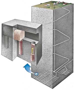

The repository relies on three protective barriers to keep radioactive substances from spreading into the environment. The spent nuclear fuel is first encapsulated in copper canisters that are nearly 5 meters (m) long and over 1 m in diameter. The outer casing is a 5-cm-thick layer of copper to protect against corrosion, and inside is a nodular cast iron insert for strength. When filled with the spent fuel, these are expected to weigh between 25 metric tons and 27 metric tons. The copper canister will then be placed in crystalline basement rock at a depth of about 500 m, embedded in bentonite clay (Figure 2). When all the spent nuclear fuel has been deposited in the crystalline basement, the tunnels and shafts will be filled in with swelling clay or a mixture of crushed rock and clay. The system will also rely on the Clab facility in Oskarshamn for interim storage of nuclear waste. The fuel will lie there in large cooling water basins for 30 to 40 years.
2.     Spent and buried in Sweden. Sweden may house the world’s first permanent nuclear waste repository if regulators approve the Forsmark site selected in early June by the Swedish Nuclear Fuel and Waste Management Co. Final disposal of the spent nuclear fuel will entail using three protective barriers. The spent fuel will first be encapsulated in copper. The impermeable copper canisters will then be placed in crystalline basement rock at a depth of about 500 meters, embedded in bentonite clay. After disposal, the tunnels and rock caverns will be sealed. Courtesy: SKB
