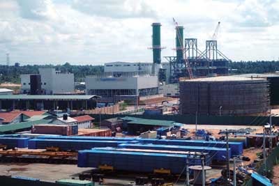

The Sri Lankan government in December commissioned the first phase of the 300-MW Kerawalapitiya Thermal Power Plant, the nation’s biggest combined-cycle power plant project. The $300 million plant in the western part of the country commenced operations by generating 200 MW (Figure 7). In its second phase, it will expand to 300 MW. Per government estimates, power produced by the plant is priced at about 20 rupees or $0.18/kWh.
7. Island power. Sri Lanka, a country that depends largely on hydropower to meet surging demand, recently commissioned a 300-MW thermal power plant in Kerawalapitiya, a region in the island nation’s west. The “Yugadanavi” is the country’s first combined-cycle power plant. The project was reportedly completed in 10 months. Several new power plants are also in the offing. Courtesy: Sri Lanka Department of Government Information
