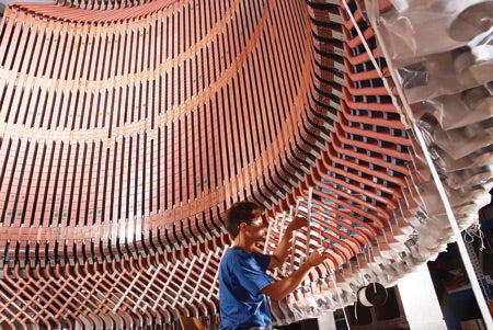

It was Voith Siemens Hydro’s first project at Heidenheim. The facility’s workers fitted the machine with a newly manufactured generator stator, and then they proceeded to give it its final high-voltage test. In this test, the stator windings’ insulation (Figure 7) had to withstand 45,000 V—more than twice the rated voltage during operation. The test was successful.
7. Immense and intricate. The first task undertaken by Voith Siemens Hydro’s Heidenheim workshop was a challenge: the overhaul of a 300-MVA hydro motor generator from Schluchseewerk AG’s Wehr pumped-storage station in southern Germany. Here, a worker assembles the machine’s stator windings. The task requires extremely thorough manual work to ensure safe and highly reliable performance of the windings during operation. Courtesy: Voith Siemens Hydro
