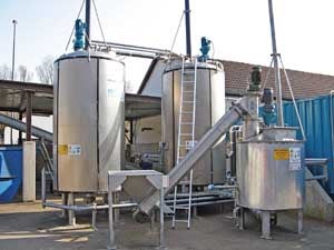

German researchers in February said they had developed the first-ever biogas plant to run purely on waste instead of edible raw materials (Figure 7). The team from the Fraunhofer Institute for Ceramic Technologies and Systems IKTS (Institut Keramische Technologien und Systeme) in Dresden said that the plant, which uses a fuel cell to convert the gas into electricity, exclusively uses agricultural waste such as corn stalks — and it generates 30% more biogas than conventional plants.
Figure 7. Stepping on the biogas. German researchers have developed a 1.5-kW biogas pilot plant that runs purely on waste, such as corn stalks, instead of edible raw materials. By diverting the gas into a high-temperature fuel cell that operates at 850C (1,562F), and which could directly be used for heating, the scientists say that the plant generates 30% more biogas than conventional plants. Courtesy:Fraunhofer-Gesellschaft
