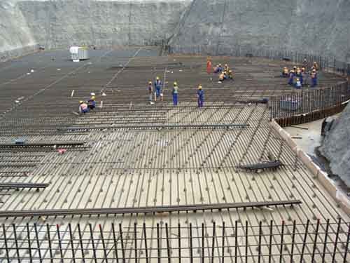

Meanwhile, the NRC’s finding seems to have no bearing on construction plans in China. Westinghouse and consortium partner Shaw Group are under contract to provide China’s State Nuclear Power Technology Corp. (SNPTC) with four AP1000 reactors. Construction of the world’s first nuclear power plant to use the reactor design began this April at Sanmen in Zhejiang province. At the end of September, crews began pouring basemat structural concrete for the two-unit nuclear island in Haiyang, Shandong province (Figure 1).
1.     In on the ground floor.
Nuclear Regulatory Commission concerns about the AP1000 may have no bearing in China, where Westinghouse and consortium partner Shaw Group have signed a contract for four AP1000s. Two units at Sanmen, in Zhejiang province, are already under construction. In September, crews laid concrete for the second two-unit nuclear island in Haiyang, Shandong province. Courtesy: Westinghouse Electric
