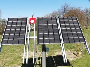

The demonstration plant was developed by the Risø researchers in cooperation with Danish companies Mekoprint — which specializes in "roll to roll" production of flex-print and printed electronics — and Gaia Solar. It consists of a single 1-meter-by-1.7-meters panel made of 24 solar cell modules, each measuring 20 cm by 25 cm (Figure 5). The active layer of the cells is polymer-based, developed using roll-to-roll methods in ambient air. The panel, placed on a tracker, produces 11 W, about 7 W of which is passed on to the grid.
5. Plastic PV power. Danish researchers at the Risø DTU National Laboratory claim to have connected the world’s first polymer solar demonstration power plant to the grid. The experimental panel measures 1 meter by 1.7 meters and comprises 24 solar cell modules, each 20 cm by 25 cm. The panel, placed on a tracker, produces 11 W, about 7 W of which is fed to the grid. Courtesy: Risø DTU National Laboratory
