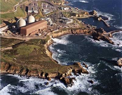

On October 21, a mass of basketball-sized jellyfish managed to accomplish what activists of every stripe had failed to do: Abruptly shut down Pacific Gas & Electric Corp.’s (PG&E) 1,118-MW Diablo Canyon Unit 2 reactor in San Luis Obispo County, Calif. (Figure 8).
8. A slippery customer. PG&E was forced to shut down Unit 2 and down-rate Unit 1 at its Diablo Canyon nuclear power plant (shown here) in San Luis Obispo county, Calif., when a mass of jellyfish clogged the units' water intake screens. The incident was unusual—but not unique. Courtesy: PG&E
The California utility was forced to manually trip Unit 2 and operate the 1,122-MW Unit 1 at 50% capacity as a precautionary measure when scuba divers, who were sent to investigate skyrocketing water pressure readings, discovered that hundreds of moon jellyfish had clogged the units’ water intake screens. Both units had been running at 100%, PG&E told the Nuclear Regulatory Commission (NRC). Two days later, when Unit 2 finally started to exit an outage and Unit 1 was returned to full power, PG&E revealed that, though no damage had been done, the gummy masses had covered 80% of the trash racks at Unit 2 and 40% at Unit 1. Divers had to be commissioned to clear the sticky mess off the racks.
