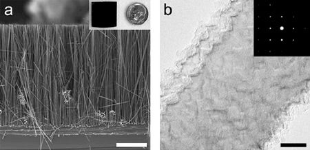

The researchers describe a unique “electroless etching” method by which arrays of silicon nanowires are synthesized in an aqueous solution on the surfaces of wafers that can measure dozens of square inches in area. The technique involves the galvanic displacement of silicon through the reduction of silver ions on a wafer’s surface. Unlike other synthesis techniques, which yield smooth-surfaced nanowires, this electroless etching method produces arrays of vertically aligned silicon nanowires that feature exceptionally rough surfaces. The roughness is believed to be critical to the surprisingly high thermoelectric efficiency of the silicon nanowires (Figure 7).
7. Miracle fibers. A cross-sectional scanning electron microscope image of an array of rough silicon nanowires includes an inset showing a typical wafer chip of these wires (a). The second photograph is a transmission electron microscope image of a segment of one of these wires in which the surface roughness can be clearly seen. The inset shows that the wire is single-crystalline all along its length. Source: Lawrence Berkeley National Laboratory
