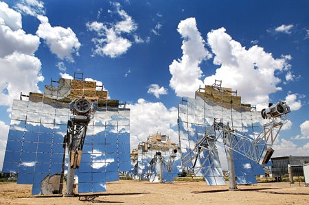

On a perfect New Mexico winter day—with the sky almost 10% brighter than usual—Sandia National Laboratories and Stirling Energy Systems (SES) set a new solar-to-grid system conversion efficiency record by achieving a 31.25% net efficiency rate. The old 1984 record of 29.4% was toppled January 31 by SES’s “Serial #3” solar dish Stirling system at Sandia’s National Solar Thermal Test Facility (Figure 3).
3. For the record books. Sandia and Stirling Energy Systems set a new world record for solar-to-grid conversion efficiency of 31.25%, eclipsing the old record of 29.4% that had stood for 24 years. Courtesy: Sandia National Laboratory, Photo by Randy Montoya
