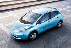

On August 2, Nissan introduced the LEAF (Figure 6), which the automaker calls the world’s first affordable, zero-emission car. Designed specifically for a lithium-ion battery-powered chassis, the LEAF is a medium-size hatchback that seats five adults and has a range of 100 miles. The car will launch in the U.S. in late 2010. U.S. production will begin in 2012, at Nissan’s manufacturing facility in Smyrna, Tenn. Nissan chief Carlos Ghosn has said the LEAF will cost about the same as a gasoline-powered car.
6. The electric vehicle, take two. When Nissan rolls out its all-electric LEAF in 2010, it will become part of the largest test project involving electric vehicles and charging infrastructure. Courtesy: Nissan
