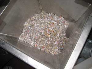

The 8-foot-high self-contained system fits inside a storage container, taking up the space of three to four parking spaces. When an operator feeds the system waste, it densifies, conditions, and converts the waste into optimized fuel pellets (Figure 6). These pellets are then converted into synthetic gas via downdraft gasification, and the synthetic gas powers a turbine-generator.
Figure 6. Waste not, want not. A waste-to-energy conversion system recently launched by IST Energy processes up to 3 tons of postconsumer waste daily with a nominal output of 120 kWe and 240 kWth. When an operator feeds the system waste, it densifies, conditions, and converts that waste into optimized fuel pellets, as shown here. These pellets are then converted via downdraft gasification into a synthetic gas, which powers a turbine-generator. Courtesy: IST Energy.
