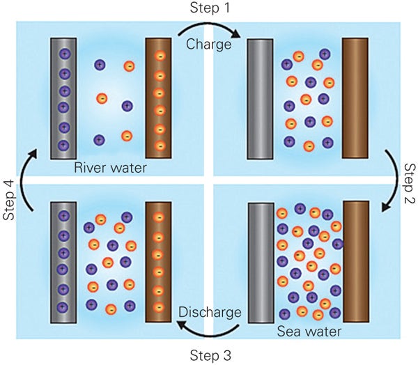

As the researchers explained in the March issue of the journal Nano Letters, the battery essentially uses two electrodes—one positive, one negative—immersed in a liquid containing electrically charged particles or ions. In water, the ions are sodium and chlorine, the components of ordinary table salt. The positive electrode is made from nanorods of manganese dioxide, which increases the surface area available for interaction with the sodium ions by roughly 100 times compared with other materials, Cui said. The researchers continue to search for a better material for the negative electrode than the silver used for the experiments, which is too expensive to be practical.
5. Worth one’s salt. A rechargeable battery developed by Stanford University researchers employs the difference in salinity between freshwater and saltwater to generate power. In the first step, a small electric current is applied to charge the battery, pulling ions out of the electrodes and into the water. In the second step, the freshwater is purged and replaced with seawater. In the third step, electricity is drawn from the battery for use, draining the battery of its stored energy, and in the final step, seawater is discharged and replaced with river water, for the cycle to begin anew. Courtesy: Yi Cui
Initially, the battery is filled with freshwater and a small electric current is applied to charge it up. The freshwater is then drained and replaced with seawater. Because seawater is salty, containing 60 to 100 times more ions than freshwater, it increases the electrical potential, or voltage, between the two electrodes. That makes it possible to reap far more electricity than the amount used to charge the battery. “The voltage really depends on the concentration of the sodium and chlorine ions you have,” Cui said. “If you charge at low voltage in freshwater, then discharge at high voltage in sea water, that means you gain energy. You get more energy than you put in.”
Once the discharge is complete, the seawater is drained and replaced with freshwater and the cycle can begin again. “The key thing here is that you need to exchange the electrolyte, the liquid in the battery,” Cui said.
