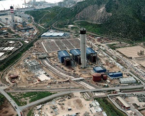

Paris-based Alstom just handed the keys to the new, 1,200-MW Cartagena combined-cycle power plant (Figure 2) to Barcelona-based Gas Natural. The facility was finished in 24 months and 12 days following its ordering in December 2003, and nine weeks ahead of schedule. Peter Papert, project manager for Cartagena, said, "It was built more quickly than any plant I've heard of. Alstom's fast-track construction process sets the speed bar very high for others."
Courtesy: Alstom Power
2. Power, pronto. This 1,200-MW power plant in Cartagena, Spain, took only two years to build. Modular parts sped assembly of equipment, and most major systems were assembled and delivered pretested on skids.
