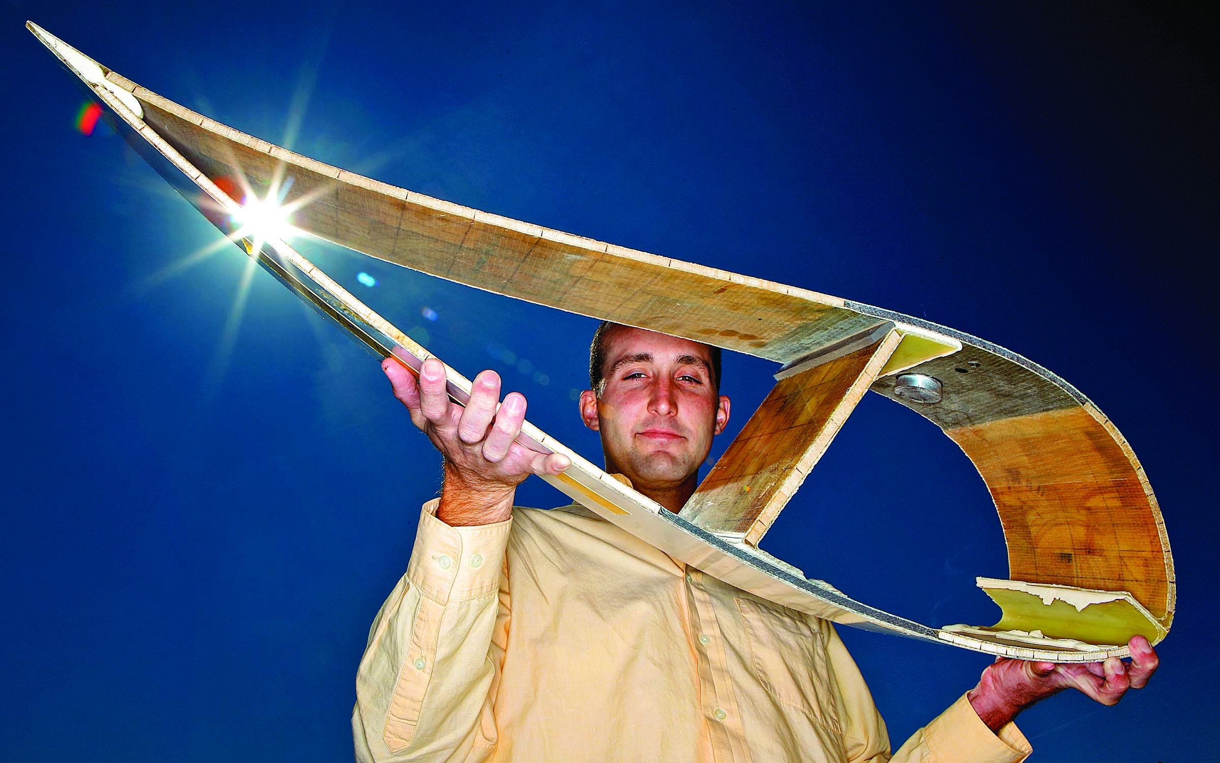

The sensors also measure two types of acceleration. One type, dynamic acceleration, results from gusting winds, while the other, called static acceleration, results from gravity and steady background winds. It is essential to accurately measure both forms of acceleration to estimate forces exerted on the blades. Research is ongoing, and the engineers are now pursuing the application of their system to advanced, next-generation turbine blades that are more curved than conventional blades (Figure 5). This more complex shape makes it more challenging to apply the technique.
5.     A smart curve. Purdue doctoral student Jonathan White holds a cross section of a wind turbine blade like the one used in research to improve the efficiency of turbines and prevent damage to blades from high winds. An engineering team has developed a technique that uses sensors and computational software to constantly monitor forces exerted on wind turbine blades. Such sensors could be instrumental in future turbine blades that have control surfaces and flaps like those on an airplane’s wings to change the aerodynamic characteristics of the blades for better control. Courtesy: Purdue University/Andrew Hancock
