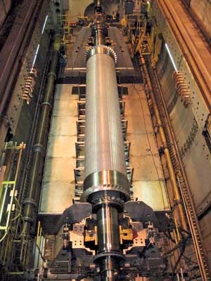

Southern California Edison’s (SCE) 2,250-MWe San Onofre Nuclear Generating Station (SONGS) recently took receipt of a new and upgraded generator rotor for one of its two Alstom steam turbine generator units (Figure 1). Following the successful installation and flawless start-up of this new rotor in the Unit 2 generator, the former Unit 2 rotor was transported to Alstom’s workshop in Richmond, Va., for refurbishment and rewinding. The refurbished Unit 2 rotor was then shipped back to California and installed in the Unit 3 machine during the plant’s fall 2008 refueling outage. Following this second rotor switch and the successful return to service of Unit 3, the original Unit 3 rotor was packed for long-term storage and is being retained on site as an emergency spare.

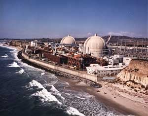

1. Ocean view property. San Onofre Nuclear Generating Station, located along the beautiful California coast between San Diego and Los Angeles, has two 1,200-MW pressurized
water reactors that needed generator rotor upgrades. The plant is jointly owned by Southern California Edison (78.21%), San Diego Gas & Electric (20%), and the city of Riverside
(1.79%). Source: Nuclear Regulatory Commission

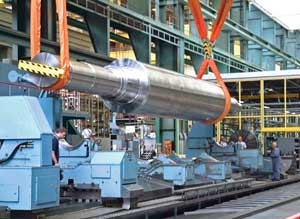

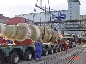

The rotor forging was manufactured by Japan Steel Works Ltd.’s facilities on the island of Hokkaido over the first 18 months of the project (Figure 2). In late spring 2005, the rotor forging was shipped to Alstom’s facilities in Birr for machining (Figure 3). In the winter of 2005, the rotor was then transported to Alstom Power in Stafford for installation of the windings, using the latest advances in insulation material for consolidated coil technology (Figure 4).
2. Packed and ready. Generator rotor forging for San Onofre Nuclear Generating Station Unit 2 en route from Japan Steel Works Ltd. to Birr, Switzerland. Courtesy: Alstom
3. Time slot. The finished turned rotor was loaded into a large milling machine at Alstom’s Birr facility, ready for cutting the rotorwinding slots. Courtesy: Alstom
4. Tightly wound. The machined rotor for Unit 2 was wound in Alstom’s Stafford, England, facility. Courtesy: Alstom

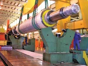

Lathe work involved installing the rotor and then performing incoming run-outs, machining the coupling, polishing seal diameters, and checking rotor blade tips (Figure 5).
5. Lathe work. The rotor underwent on-receipt run-out checks and coupling finish machining at Alstom’s Richmond, Va., service facilities. Courtesy: Alstom

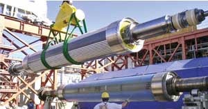

The next phase involved millwork: a combination of drilling and tapping coupling drive pinholes and installing adapter plates, along with the installation of 54-inch- and 76-inch-diameter fan hubs and blades. After more lathe work, the rotor was placed in the balance pit for balancing, overspeed testing, and two heat runs (Figure 6). After final run-out measurements and checking, the rotor was packed for long-term storage and carefully placed back on the rail car.
6. Heavy lift. Alstom’s Richmond facility completed the final machining, assembly, balancing, and acceptance testing. The 350-ton-capacity high-speed balancing facility is one of the largest in North America. Courtesy:Alstom
