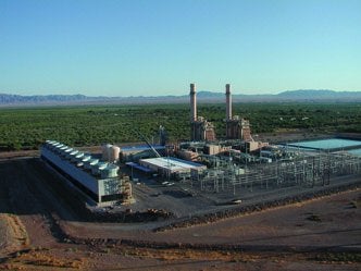

Calpine Corp.'s South Point Energy Center in Mohave County, Ariz. (Figure 1) is a 520-MW natural gas-fired, combined-cycle facility with two Siemens Westinghouse 501FD gas turbines and one steam turbine-generator with a BB33 high-pressure (HP) section, a BB65 intermediate-pressure section (IP), and a 65CC intermediate/low-pressure (LP) section. The plant entered commercial service in June 2001.
1.	Down in the desert. Calpine Corp.'s South Point Energy Center, a 520-MW combined-cycle facility in Arizona, recovered quickly from a crash caused by the failure of a steam-turbine blade. Courtesy: Wood Group
A recent crash of South Point was a plant engineer's worst nightmare. One of the final-row blades in the steam turbine's LP section failed, causing extensive damage to the turbine and generator. The huge vibrations produced by the liberated blade then shook loose some of the lube oil drain and supply lines, and the released lube oil ignited when it came into contact with turbine casings, at around 1,000F. The failure also caused condenser tubes to puncture, dousing the casings with water as well. The vibration caused by the quenching increased the friction between all mating components of the turbine and generator, welding them together. All turbine and generator bearings and the generator's rotating and stationary components appeared to be extensively damaged (Figure 2).
