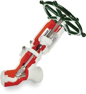

For example, a butt-welded, stainless steel system used to transfer caustic fluids will require a significantly different valve construction than a flanged valve in a carbon steel pipe system throttling steam or water. A generic request for a size 4, Class 900 globe valve does not communicate this critical information to the valve manufacturer (Figure 1).
1.    Globe varieties. Globe valves are distinguished by an element that closes parallel to the direction of flow. Available styles are T-pattern, angle, and Y-pattern (shown). Courtesy: Flowserve

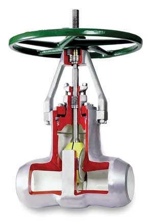

The throttling ability of a globe valve can be of significant interest for an end user, although it comes at a relatively higher price. A globe valve, size-for-size, will have a higher pressure drop than a gate valve. The straight-through design of a gate valve offers negligible pressure drop but is a poor choice for throttling applications (Figure 2).
2.    Gate varieties. Gate valves are distinguished by an element that closes perpendicular to the direction of flow. Styles include wedge, flex wedge, double-disc, and split wedge (shown). Courtesy: Flowserve
It is not uncommon for a new design engineer to specify the requirement for a gate valve in a throttling application due to the lower pressure drop at the full open position. However, the closure element of a gate valve is prone to damaging vibration in partial stroke positions and is therefore not appropriate for throttling applications.
