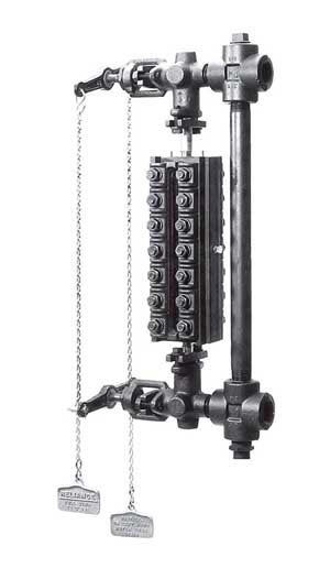

According to the National Board, a water column, if used, must be connected to the boiler using a cross or equivalent pipe fitting at each right-angle connection to allow visual inspection and cleaning of the connecting pipes. Sludge or sediment of any kind in the water column or connecting pipes can cause false water level indications (Figure 4).
4. Old reliable. The flat glass water gauge remains the mainstay of boiler drum water level measurement. Courtesy: Clark-Reliance
The ASME code requires a 1-inch minimum connection size from the boiler to the water column and a ¾ -inch minimum connection size from the boiler to a remote level indicator. Gauge glasses that are required by code may be connected directly to the shell or drum of the boiler or to an intervening water column. When two gauge glasses are required, both may be connected to a single water column.
Section 1 of the code has standards for the highest and lowest permissible water level in water column connections. The lower edge of the steam connection between a water column and level indicator device shall not be below the highest visible water level in the gauge glass.
Conversely, the upper edge of the water connection between a water column and level indicator device shall not be above the lowest visible water level in the gauge glass. These parameters are established to prevent any accidental overheating of the boiler, leading to unwanted downtime and possible worker injury.
