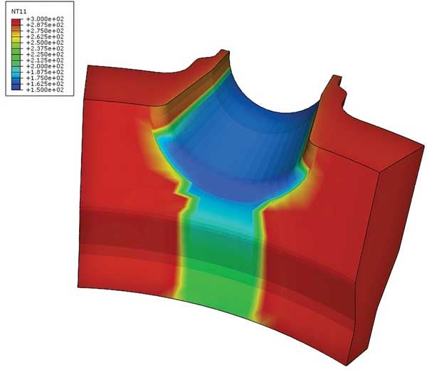

11. Shock treatment. This is a one-fourth cutaway view of a reactor pressure vessel at the start of a pressurized thermal shock simulation by TÜV, using Abaqus FEA from SIMULIA. The vessel, which normally operates at 300C (indicated in red), is shown as cooler water (30C) begins pouring in through the nozzle on the top right. (Units are degrees Celsius.) Source: TÜV

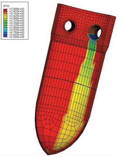

12. Thermal shock wave. This Abaqus FEA half model of a reactor pressure vessel shows the nozzle opening (shown as holes in Figures 11 and 13) through which cold water is quickly introduced to shut down the reactor, resulting in pressurized thermal shock. TÜV requires virtual testing of nuclear power plant components as part of the certification process. (Units are degrees Celsius.) Source: TÜV

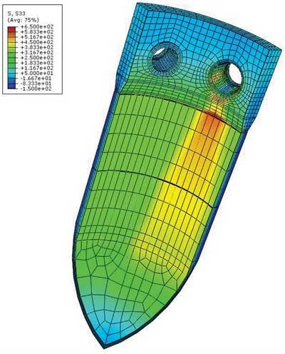

First, the thermal conductivity of the two materials (cladding and base) is different, so each reacts differently to the rapid temperature change. Second, the emergency injection of colder water creates a temperature plume (temperatures inside the plume are significantly lower than those outside) that produces significant stress buildup at its leading edge (Figure 13).
13. All stressed out. The same reactor vessel as shown in Figure 11, but further into the pressurized thermal shock simulation, shows the stress distribution on the inner wall of the reactor pressure vessel (from red to blues and greens. (Units are degrees Celsius.) Source: TÜV
