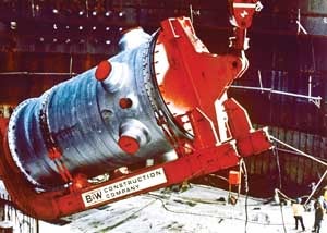

A typical FEA analysis of an RPV takes into account temperature transients, internal pressure fields, and the radiation embrittlement behavior of the vessel during a simulated LOC event. (The case described here is taken from an actual evaluation by TÜV at the recertification of a power plant in Germany.) The simulations examine stresses both at vessel walls and at entry points of the hot and cold water nozzles feeding into the RPV (Figure 10).
10. Nozzle flow. An exterior view of the nozzles (with red caps) through which hot and cold water circulate into and out of a nuclear reactor pressure vessel that houses the fuel rods. Courtesy: Westinghouse
