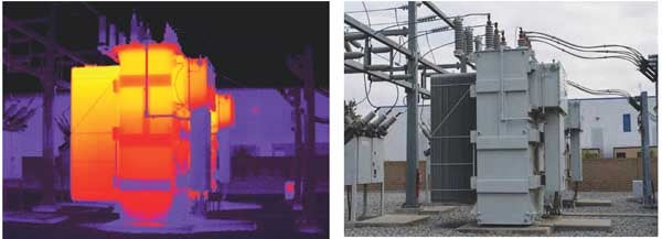

Because transformers are extremely expensive and essential to the proper functioning of electrical systems in a plant, they are a good example of the effective use of thermography (Figure 5).
5.   Transformer inspection. A thermogram of a 66-kV/12.4-kV transformer shows all is well during this inspection. Capture and record a baseline or footprint to compare for future inspections. You will need data for the trending. Courtesy: City Light and Power
When taking thermal images of transformers, the effect of the heat transfer in the insulating oil must be considered. Although it’s not necessarily a cause for concern on other equipment, a temperature rise of 5 degrees on an oil circuit breaker or load tap changer could indicate a serious problem, so check oil levels prior to taking thermal images of transformers.
Next, capture and record a baseline or footprint to compare for future inspections (Figure 6). You will need this data for trending. It is a good idea to take thermal images of bushings, lightning arrestors, radiators, fans, load tap changers, and ground connections. Confirm the fan settings and then operate the fans, if possible. Take thermal images of the cooling tubs and radiators to identify uneven heat distribution or blocked tubes or radiators.

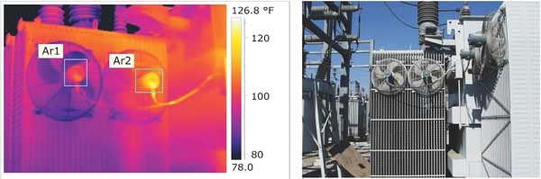

6.   Too hot to handle. A later inspection of the 66-kV/12.4-kV transformer cooling fans
clearly shows a failed fan motor. Courtesy: City Light and Power
In this 66-kV/12.4-kV transformer, the forced air-cooling circuit tripped out because of a bad fan motor. Some emergency switching was performed to reduce the secondary load on the transformer. Evaporative coolers were installed before the oil temperature became critical.
