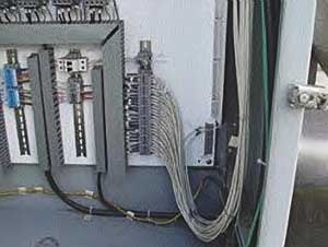

Prior to taking thermal images of equipment, it is important to become familiar with how to operate the camera. Once that is fully understood, attach all the required cables to the camera and turn it on. Make sure that both the camera and the viewfinder are focused, if the viewfinder has such an adjustment (Figure 1). Viewfinders are recommended for working outdoors, and external monitors are recommended when working indoors. In addition, take care to ensure that direct sunlight does not enter through the eyepiece, which would damage the video display. It is a good idea to cover the lenses with lens caps and to remove batteries from the camera when it is not in use.
1.     Focus the image. A focused image is not only easier to view but it also looks more professional, and the apparent temperature will be higher when viewing a hot  spot. Courtesy:City Light and Power

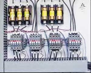

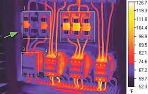

Set Level and Span. Temperature span is like "Thermal Contrast." In fact, it is similar to the contrast control adjustment on television sets. Level is like "Thermal Brightness" and is similar to the brightness adjustment on television sets. This is often referred to as thermal tuning. Figure 2 shows an example of proper temperature span setting on an ammonia injector heater electrical control panel. From the thermograph it appears that one fuse is blown. Thermal imaging can also detect such things as balanced and unbalanced loads, as shown in Figures 2 and 3.
2.    Confusing options. This ammonia injector heater electrical control panel appears to have a blown fuse. Courtesy: City Light and Power
3.   Unbalanced load. The ammonia injector heater electrical control panel wires (L) are fiberglass-wrapped insulation and have unbalanced electrical loads (C). A infrared scan after the loads were balanced (R) showed a more even temperature spread. Courtesy: City Light and Power
