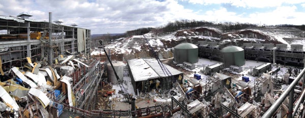

The new standard, “NFPA 56PS: Standard for Fire and Explosion Prevention During Cleaning and Purging of Flammable Gas Piping Systems,” was released on Sept. 27, 2011. According to the NFPA, “The new standard was developed in the wake of the 2010 explosion at the under-construction Kleen Energy Power Plant in Middletown, Conn. that killed six workers and injured nearly 50 others and a subsequent investigation by the CSB.” (See “Natural Gas Piping: It’s Time for Better Risk Control” in our May 2010 issue, available in the POWER archives at http://www.powermag.com.) As part of the commissioning process for the Connecticut facility, highly pressurized flammable gas (natural gas) was used to clean debris from the piping and was then discharged without controls into the atmosphere, causing the explosion (Figure 1).
1. Connecticut calamity. Workers at the Kleen Energy Systems plant in Middletown, Conn., attempted to clean debris in the plant’s fuel gas line with 650 psi natural gas. The gas purge, vented inside the plant building, found an ignition source and exploded. Six workers were fatally injured and more than 50 workers were injured. The financial cost of the explosion has been estimated at up to a billion dollars. Courtesy: Chemical Safety Board
