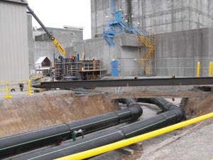

As this was to be the first ever use of HDPE in a safety-related water pipe system at a nuclear plant in North America, the team at Callaway had to create a material specification and related procedures from scratch. In the process, they underwent a change in mindset from focusing on what was available to specifying what was really needed. Most importantly, Callaway engineers began to work closely with members of the HDPE pipe value chain. These players included The Dow Chemical Co. (Dow) as the HDPE supplier, WL Plastics Corp. as the pipe manufacturer, and Independent Pipe Products Inc. for the manufacture of special pipe fittings. The consultant, Frank Schaaf, Jr. of Sterling Refrigeration Corp., was also instrumental in the work necessary to gain approvals from the NRC (Figure 3).
3.    Plastic replaces steel. HPDE pipe and joint fittings were required to be tested to confirm that they met the quality and safety specifications of ASME Class 3 nuclear service piping systems. AmerenUE submitted a special Relief Request to the NRC in 2008 demonstrating that HPDE pipe could be used instead of carbon steel pipe. Courtesy: Dow Chemical Co.
