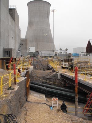

AmerenUE, a subsidiary of Ameren Corp., has pioneered the use of polyethylene (PE) as a new alternative to steel pipe ESW systems at its 1,200-MW Callaway plant. Polyethylene material does not corrode, rust, rot, pit, tuberculate, or support biological growth. It also has an outstanding field performance record for more than half a century in water piping systems. Taking advantage of material science advances in bimodal polyethylene resins and a collaborative effort with a resin supplier, a pipe manufacturer, a pipe fittings manufacturer, an engineering contractor, and a primary construction contractor, AmerenUE engineers and construction teams have successfully replaced the carbon steel ESW pipe system at Callaway with a new class of bimodal high-density polyethylene (HDPE) pipe (Figure 2).
2.    A nuclear industry first. Installation of an underground essential service water pipe system made from bimodal high-density polyethylene or HDPE at AmerenUE’s Callaway Nuclear Power Plant in Fulton, Mo., was an industry first. Courtesy: Dow Chemical Co.
Prior to the installation at Callaway, PE pipe had not been used for a safety-related ASME Class 3 water pipe application at a nuclear power plant in the U.S. AmerenUE’s use of bimodal HDPE met all design requirements, was validated with extensive test data, and has also received approval from the Nuclear Regulatory Commission (NRC). This use of HDPE in a safety-related water pipe system is a first for the U.S. nuclear power industry and could be instructive for other nuclear utilities grappling with steel water pipe corrosion issues.
