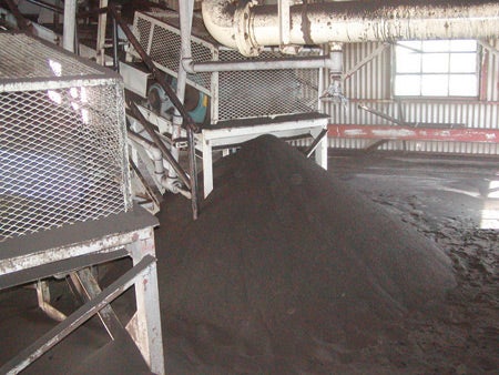

  • Checking for any coal spills (Figure 1) or excessive dust accumulation and identifying the source.

1. Poor housekeeping. Coal accumulating at the tail of a conveyor not designed to handle Powder River Basin coal is an extreme fire hazard. Source: POWER magazine

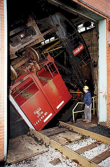

2. Easy dump. A properly designed dust collection system is a must for every rail car unloading station. Courtesy: DOE

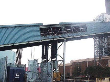

Most controls for cascading conveyor systems shut the system down to avoid a large spill should a conveyor fail for any reason (Figure 3). Because this is critical to limiting the spread of a possible fire, conveyor controls should also be checked routinely.
3. Inviting problems. The need to remove the siding from a conveyor to increase ventilation is a sign of a poor design. Source: POWER magazine

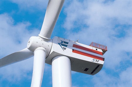

All wind turbines are large, but the REpower 5M wind turbine is huge. Built and marketed by REpower Systems AG of Hamburg, Germany (www.repower.de), the 5M (Figure 4) stands 394 feet high and produces 5 MW of power. With three blades of 413-foot diameter, it is one the largest and one of the most efficient wind turbines in the world. Two of the toughest tasks involved in creating the 5M were designing and manufacturing a bearing system for the 59-inch-diameter shaft that supports the machine's three-bladed rotor, which weighs in at over 130 tons.
4. Heavyweight class. The size, efficiency, and capacity of REpower's 5M wind turbine set new standards for the worldwide wind power industry. Courtesy: SKF

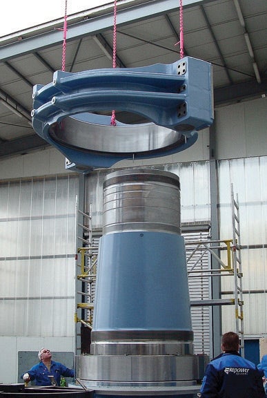

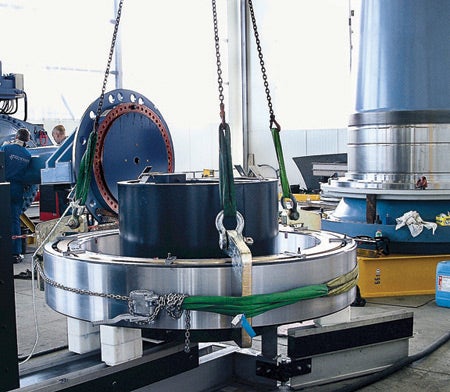

Because the roller set in the CARB bearing weighs almost 1,800 lb, it had to be specially clamped during heat-up and assembly (Figure 6). Without induced safe clamping, the weight of the rollers would cause them to clamp loosely between the inner and outer ring, which could damage the raceways. This kind of loose clamping also occurs in standard-size bearings mounted vertically, but standard-size bearings weigh much less, so it does no harm. However, to improve quality assurance, SKF also clamps smaller bearings to ensure safe mounting.
6. Tight fit. The 17,600-pound CARB housing being lowered onto the hollow cast-iron shaft. Courtesy: SKF
