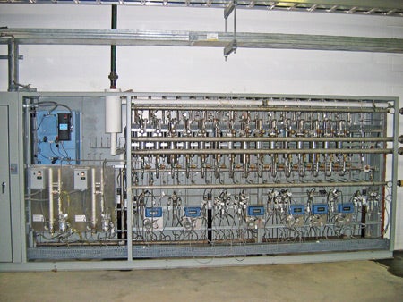

Many plants have common problems with the same kinds of water sample panels and on-line analyzers. Although every site and sample panel is unique (Figure 3), there are some basic tips and tricks that can be used to address many of those problems. (For the larger context of this issue, see "Maintaining water sample panels improves plant availability.")
3. Where the action is. The back of a typical sample panel. Courtesy: Nalco

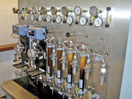

High cation conductivity. Exhausted resin is the most common cause of high cation conductivity (Figure 5). Solving the problem is as simple as replacing the resin before it's depleted. Plants should maintain a full set of replacement resin on site that's ready for use. The best practice is to maintain the same number of replacement resin sets (or resin volume) in inventory as there are installed cation columns.
5. Shoot the moon. High cation conductivity caused by exhausted resin. Source: Nalco
Most of the cation conductivity resins in use are supposed to change color as they exhaust. Plant maintenance and chemistry personnel rely on this color change to indicate when the resin needs to be replaced. Unfortunately, sometimes the color change is subtle, or masked by the effect of a contaminant. For example, iron fouling can make a resin dark enough to obscure the change in hue. Other foulants can cause the resin to stop exchanging even if it's not exhausted, again masking the color change. If the color of a resin does change, it should be replaced while at least 10% of the resin remains unexhausted.
As a rule of thumb, replace the cation resin any time the cation conductivity consistently reads higher than 2 µS/cm (microSiemens/centimeter). Cation conductivity should never consistently read greater than this value. Finally, for accurate readings of degassed cation conductivity, ensure that the heaters are energized or that nitrogen is flowing any time that sample is flowing through the cation column. The degassed reading is supposed to eliminate interference caused by carbon dioxide, but that's only the case if the small reboiler heaters are energized or if the scrubbing nitrogen is being fed.
