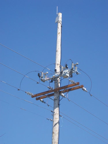

CUB recently began the second phase of its Scada system installation: enabling communications with pole-top devices (reclosers, regulator controls, automated switch controls, and capacitor controls) on distribution lines (Figure 12). ProSoft's RadioLinx radios will be the primary communications vehicles. So far, the radios have been connected to Cooper Form 4C and Form 6 recloser controls and to Model 5801 automated switch controls from Chicago-based S&C Electric Co. The only protocol available for the Cooper Form 4C controls is Cooper 2179, which is not supported by the Scada master. The communications path to each of those controls starts at the "com" port on a substation RTU, goes through a serial radio to the same repeaters used for substation communications, and ends at the serial radio connected to the control.
  1
2. Off the beaten path. In Tennessee's Cumberland Mountains, Clinton Utilities Board is four years into a project whose ultimate goal is to wirelessly interconnect its Scada system, 13 substations (two extremely remote ones), and thousands of pole-top devices. Courtesy: ProSoft Technology Inc.
Currently, Clinton Utilities Board has ProSoft 23 radios installed, and it hopes to double that number within the next six months. With such robust integration in its remote networks, any installed radio can then become a repeater for future radios.
