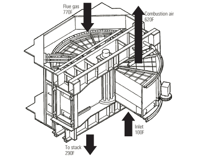

Regenerative air heaters capture the heat in boiler exhaust gases by passing those gases through heat-absorbing metallic elements. The elements slowly rotate and alternately contact the hot gases and the cool inlet air from boiler fans. The captured waste heat is released into the inlet air, preheating it just before it enters the boiler (Figure 3).
3. Around the edges. Typical temperatures in a regenerative air heater. Source: Paragon Airheater Technologies
Sealing these types of heaters is extremely difficult due to their large diameter (up to 60 feet) and the large temperature difference between the hot and cold sides (about 400F), which produces dynamic thermal distortion of the rotor. The outer edge of a large hot air heater typically distorts by 2 inches or more (compared with the cold condition), providing a large gap through which plenty of air can escape.

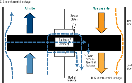

Figure 4 shows common leakage paths for typical air heaters. Paths A and B illustrate radial leakage between the sector plates and the basketed element on the cold and hot sides, respectively. Radial leakage raises required boiler fan horsepower because it does not contribute to combustion, yet it still must be moved. Paths C and D show circumferential leakage, in which air leaks past the outside of the rotor and thus either fails to be preheated (path C) or fails to transfer its heat to the air heater (path D). Circumferential leakage does not increase fan horsepower because it still makes its way to the boiler. However, circumferential leakage does adversely impact heat transfer and boiler heat rate.
4. Down the drain. The sum of radial and circumferential leakage in air heaters typically exceeds 25%. Radial leakage can reach up to 350 feet/second. Source: Paragon Airheater Technologies
