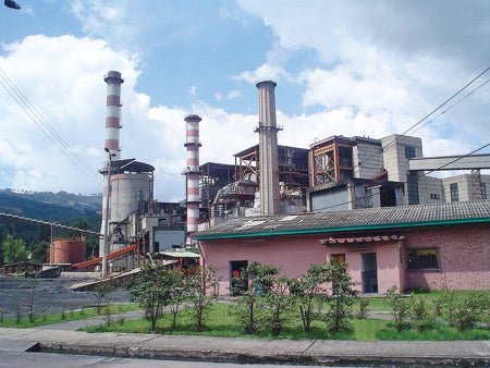

The coal-fired boiler powering the 165-MW Unit 1 of the Termopaipa facility (Figure 2) was designed by Stein & Roubaix in 1957 using the design techniques of Combustion Engineering and (presumably) the latest ASME Boiler & Pressure Vessel Code.
As inputs, the recent remaining-life analysis used data from a detailed boiler inspection of August 2006, plant design details, and historical plant operating records. Unlike Termocentro, Termopaipa operates every month, but only for a few hours, so most start-ups are cold.
2. Live long and prosper. Gensa recently assessed the remaining life of pressure parts in the coal-fired boiler powering Unit 1 of its Termopaipa plant. Courtesy: Tetra Engineering Inc.
The first part of the analysis concentrated on identifying the key damage mechanisms that might affect boiler components under pressure: waterwall tubing, economizer tubing, superheater tubing, and high- and low-temperature headers. Probabilities of these mechanisms occurring were then calculated and extrapolated into predictions of the components' remaining useful life. With these equipment "actuarial tables" in hand, plant staff are now making the transition to a more predictive mode of boiler maintenance.
