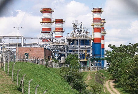

The need for maintenance has been made more urgent by Colombia's increased attention to environmental protection. Most coal-fired plants in Colombia, like Termopaipa (Figure 1), were built in the 1960s and reflect best environmental designs and practices of that era. Since then, national air pollution standards have become much stricter. To comply with them, coal-fired plants have had to install control devices such as electrostatic precipitators and pay closer attention to efficient O&M of all equipment.
1. Colombian combined-cycle. Isagen's 2 x 1 gas-fired Termocentro power plant must start up quickly when hydroelectric power supplies dip. Courtesy: Tetra Engineering Inc.
