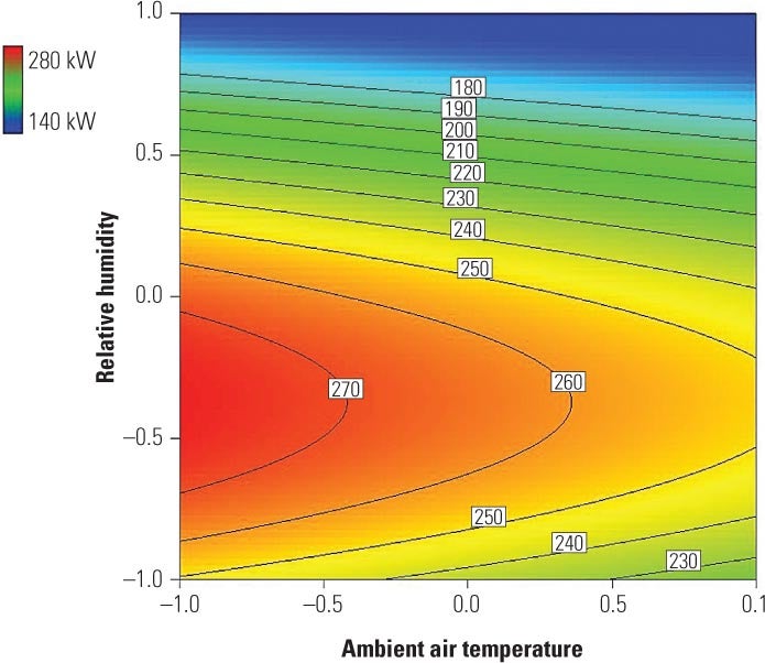

7. Maximum power as a function of humidity and inlet air temperature. The DOE results map illustrates the power predicted for an engine for a given set of site conditions as a function of humidity and inlet air temperature in coded values. This prediction is important to understand because the ambient conditions from site to site, or even at a single site, can vary greatly. The figure shows that the highest power output of the engine is achieved when the inlet temperature and humidity are both low. Inlet air is denser under these cool and dry conditions than when it is hot and damp, allowing the engine to induct more air to burn with more fuel. The data are shown in terms of percent variation from a design point for proprietary reasons. Source: Dresser Waukesha and Stat-Ease

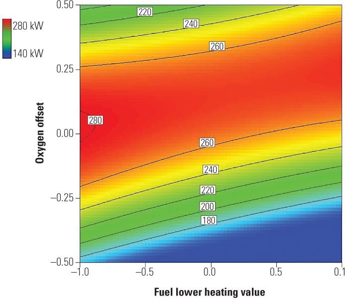

8.    Maximum power as a function of fuel heating value and air/fuel ratio. The DOE results map illustrates the predicted power as a function of fuel heating value (LHV) and air/fuel ratio (O2 offset) in coded values. Since the engine can be applied in applications that run on low-energy-content landfill or digester fuel gas in which the fuel quality can fluctuate, it is also important to understand how the fuel heating value and air/fuel ratio affect maximum power. For this engine, the air/fuel ratio required to reach the maximum power output changes with the lower heating value of the fuel. The lower the energy content of the fuel, the richer the air/fuel ratio must be to reach the same power output. Data are shown in terms of percent variation from a design point for proprietary reasons. Source: Dresser Waukesha and Stat-Ease
