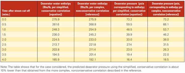

A solved example explaining the methodology for evaluating the effect of the DA pressure transient on the BFW pump NPSH is presented below. Note that the hot restart transient is not part of this calculation. Calculation of the residence time requires dimensional information of DA and the BFW pump suction piping.

Step 2: Perform the calculations. Use the data above with the equation provided earlier to develop the results shown in the table.
For the present case, the residence time is assumed to be 0.5 min and therefore becomes the critical point. At this point, the table shows a reduced DA pressure of 59.45 psi (or 66.1 psi, depending upon the correlation used). The actual pressure at pump suction then corresponds to DA pressure of 59.45 psi + 34 psi (where 34 psi equals the static head minus friction loss) = 93.45 psi. However, the pump suction vapor pressure during the residence time remains unchanged at 73.2 psi. This provides a margin above the pump suction vapor pressure of 93.45 – 73.2 = 20.25 psi (equivalent to 52 ft of NPSHa).
Step 3: Evaluate the results. If this calculated value of NPSHa = 52 ft is less than the NPSHr provided by the pump vendor, the pump is expected to cavitate during the transient. This means the design is inadequate and should be revised. If the NPSHa is larger than the NPSHr provided by the pump vendor, then the system should work satisfactorily during a similar pressure transient.
