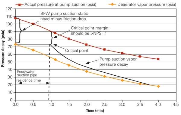

Figure 2 shows a plot of the actual measured pressure at the BFW pump suction and the DA vapor pressure for a typical steam power plant. The difference is the available NPSHa at the pump inlet. Also note that during the DA pressure transient, the actual pressure at pump suction decreases as the DA vapor pressure decays for almost a full minute. However, due to the time it takes for this hot-water slug in the pump suction line to pass, the pump suction vapor pressure does not decrease until after the "critical point," corresponding to the BFW pump suction pipe residence time where the NPSHa is at a minimum. If the value of NPSHa at this point (critical point margin) falls below the pump NPSHr, the system design is inadequate and the pump could be damaged due to cavitation of the fluid inside the pump during the transient.
2. Good correlation with theory. The proposed simplified calculations to determine NPSH in the deaerator system give a close, conservative estimate of the more analytic approach described in the reference. Source: Bechtel Power
