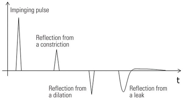

The theory behind APR is to inject a wideband acoustic pulse into a pipe. This pulse acts as a form of “virtual probe.” As long as the pulse encounters no discontinuities, it continues to propagate down the tube. Whenever a discontinuity is encountered—such as a blockage, expansion (due to wall loss, for example), or hole—a reflection is created. The reflected waves propagate back down the tube, where they are recorded for analysis (Figure 5).
5. Different discontinuities have different signatures. In tubes belonging to heat exchangers, any sensed discontinuity represents a fault. Source: AcousticEye
The ultimate purpose of tube inspection should be to examine tubes as rapidly as possible and then analyze the measurements both rapidly and using objective criteria. Keeping this in mind, APR is very well-suited to this task on both counts. The pulse acting as a probe travels through the tube at the speed of sound, resulting in inspection rates much faster than those possible with other techniques. Measurement of a single tube takes only several seconds, and there is no physical probe to push through the tubes or become stuck. The resultant measurements can then be analyzed by appropriate signal processing software, which is faster and more objective than human analysis.
