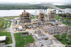

Plant engineers are adept at managing and maintaining aged equipment at the 800-MW Michoud power station, located 10 miles east of New Orleans (Figure 3). From November 2006 to November 2007, the generating station’s two units were off line less than 116 hours. Michoud Unit 2 operated 6,770 service hours, and its Unit 3 provided an exceptional 6,946 hours of service.
3. Prime performer. Plant engineers are adept at managing and maintaining aged equipment at the 800-MW Michoud power station, located 10 miles east of New Orleans. From November 2006 to November 2007, the generating station’s two units were off line less than 116 hours. Michoud Unit 2 operated 6,770 service hours, and its Unit 3 provided an exceptional 6,946 hours of service. Courtesy: Hach Co.
