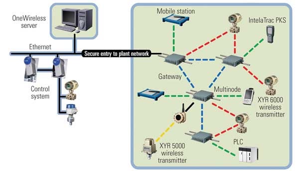

According to wireless technology experts, the emerging wireless infrastructure will be based on a universal mesh network supporting multiple wireless-enabled applications and devices within a single environment (Figure 3). With just one network supporting multiple applications, deployment, network maintenance, and security management will be simplified.
3. Once is not enough.
A wireless mesh network has multiple paths between access points (nodes) to establish a redundant infrastructure. Source: Honeywell Process Solutions
A wireless network must be secure to ensure the entire facility is safe, offering one comprehensive and end-to-end integrated security system from the control or host system all the way down to the sensor. This means there’s only one wireless security system to manage. A layered approach to security means protecting the network from multiple risks.
Mesh networks use a self-propagating, self-healing network of nodes to achieve blanket coverage of an area. A node can send and receive messages, and in a mesh network, a node also functions as a router and can relay messages for its neighbors. If one node fails for any reason, including the introduction of strong radio frequency interference (RFI), the network can reroute data, and connectivity will not be lost.
