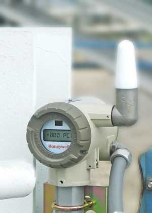

The new breed of wireless transmitters enables plant workers to obtain data and create information from remote and hazardous locations without the need to run wires, where running wire is cost-prohibitive and/or the measurement occurs in a hazardous location (Figure 2).
2. Wireless solution. An example of a transmitter installed at a facility. These wireless transmitters bring back data from remote areas of the plant into the control system to improve safety and efficiency. Source: Honeywell Process Solutions
There are countless remote applications in power plants that can benefit from wireless technology. For example, one Nebraska power plant is using wireless technology to monitor its remote oil tanks. In addition, plant staff are now able to efficiently monitor water run-off where electricity is unavailable. Battery-powered transmitters transmit data over long distances back to a powered node.
