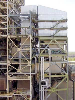

In 2006, Hitachi Power Systems America Ltd. (Hitachi) was awarded an engineering, procurement, and construction contract by SECI for a selective catalytic reduction (SCR) system retrofit on both SGS units (Figure 3).
3.    Latest air emissions reduction upgrade. Hitachi designed and installed selective catalytic reduction (SCR) systems on both units at SGS. Post-installation testing showed the SCRs exceeded the 90% contract guaranteed NOx removal rate. Courtesy: Hitachi Power Systems America Ltd.
Hitachi’s contract included the design, supply, and erection of the SCR systems to achieve 90% NOx reduction. This goal was achieved through the integration of Hitachi’s process system design with Hitachi’s low SO2 -oxidation, plate-type catalyst. The SCR system also includes:

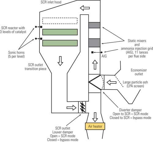

Operation of the gas diversion system is relatively straightforward (Figure 4). Diverter dampers and SCR outlet dampers are installed in the flue gas path and operated together to divert the flue gas through the SCR (SCR mode) or to bypass the flue gas around the SCR (SCR bypass mode). SCR mode is achieved with diverter dampers open toward the SCR and the SCR outlet dampers open. SCR bypass mode is obtained with diverter damper closed toward the SCR and the SCR outlet louver damper closed. NOx monitoring is performed before and after the SCR.
4.    Pick your path. The flue gas path of each SCR system is illustrated. During the Phase 1 outage the existing economizer outlet flue was demolished, with the exception of the last 20 feet of the air heater inlet flue, and new diverter dampers and economizer outlet/air heater inlet flues were installed.  Source: Hitachi Power Systems America Ltd.
