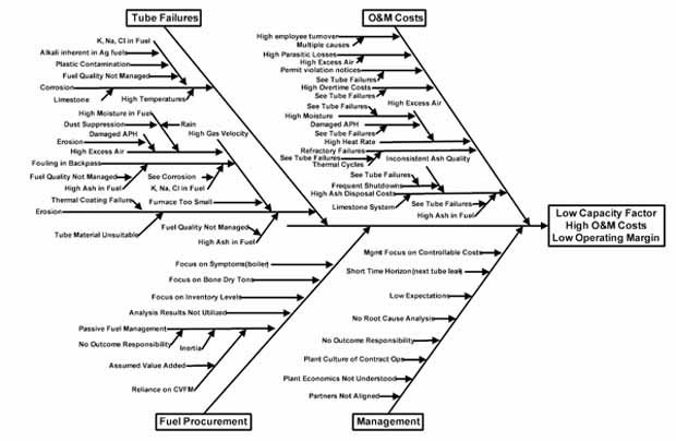

A strategic analysis of the plant’s operations was guided by Gross and ably aided by consultant Sterling Energy early in 2008. The resulting report proposed four strategic options addressing the four major challenges the plant needed to meet before returning to design performance (see fishbone diagram for all the specific challenges faced).
Fishing for problems. A fishbone diagram was prepared to visually represent the type of challenges that were addressed by the Rocklin staff and how interrelated so many of the problems are. This diagram was used to develop the scope of work for the plant upgrades. Source: Constellation Energy
The status quo was not acceptable given that it would lead to insufficient cash flow to sustain operations. After careful consideration, plant owners elected to make a significant investment in correcting the plant’s operational and management course and, in return, have a plant that operates at high reliability for many years to come.
A careful analysis of the plant’s "as found" condition identified the key problems that had to be resolved:

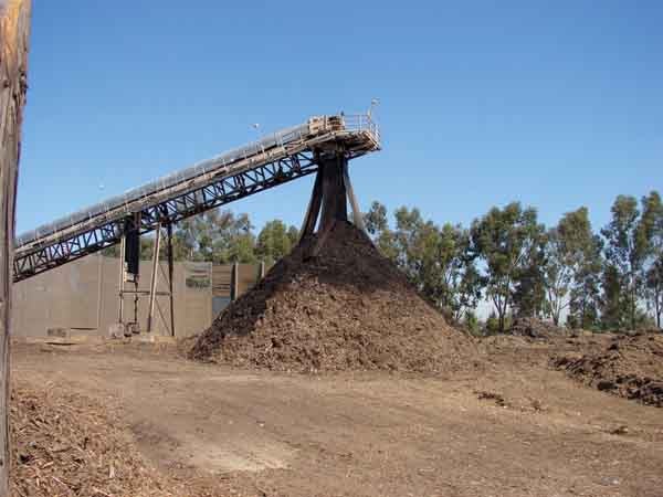

Assume Control of Fuel Management. The quality of the fuel supply had dropped over the years. Low-quality fuel led to increased boiler and equipment maintenance and, therefore, lower plant reliability. Historically, a series of fuel contracts were placed, and trucks of fuel arrived and left their loads on the fuel pile. However, purchases from the contract suppliers meant giving those suppliers the responsibility for delivering a quality fuel that met the contract guidelines. Rocklin’s experience was that suppliers often delivered fuels that were outside the fuel specification and that included rocks, sand, or noncombustibles or were high in potassium, sulfur, lead, or chlorine — all of which directly lead to increased boiler maintenance (Figure 3).
3.    Fuel czar appointed. Rocklin cancelled its fuel supply management contract and appointed a member of the plant staff to directly contract with fuel suppliers and offer them incentives for high-quality fuel. Courtesy: Constellation Energy
To address this problem, plant management assumed control of the fuel supply by terminating the plant’s fuel supply management contract and then appointing a fuel manager with the specific responsibility of managing suppliers and holding the line on fuel quality. New suppliers that could reliably deliver clean fuel were added; those that could not were cut loose. New quality metrics were quickly instituted, as well as an incentive system for quality fuel deliveries. If a truckload did not meet the fuel specification, that load was rejected and removed by the fuel supplier from the plant.
Today, fuel purchases are made at a 3:1 ratio of qualified contract suppliers to spot market purchases. The quality of fuel delivered to the plant rose substantially as a result of the plant taking control of its fuel supply. The plant normally maintains an 18-to-20-day onsite supply of fuel.

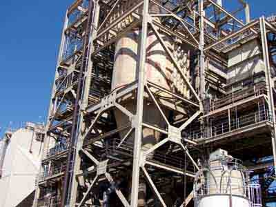

Fix the Systems That Aren’t Working Properly. The owners invested about $14 million in the Rocklin renovations, which were primarily related to boiler refurbishment. A spring 2008 outage of about seven weeks that was managed by Constellation Energy’s Generation Services support group was scheduled to complete the boiler upgrades. A steam turbine overhaul was completed at the same time.
The scope of work for the boiler overhaul was extensive but necessary given the historic rates of boiler tube leak – caused forced outages. During the planned overhaul outage, the entire economizer was replaced, as was the primary superheater tube bank. The boiler water tubing in the combustion zone of the CFB was retubed. New retractable sootblowers were installed and calibrated. Just about every region of the boiler was either replaced or repaired, as in the case of badly corroded or eroded tubes that had routinely caused forced outages. Rotary valves and screws that feed the wood fuel into the CFB furnace were repaired or replaced. These components must operate against higher furnace-side operating pressures than those found in a typical coal-fired plant, so they remain high-maintenance components.
Another significant challenge was developing a program to repair combustor erosion on an ongoing basis. Rocklin has had some good success using thermal flame spray to repair eroded boiler tubes, although the process remains more art than science. Maintaining cyclone outlet temperatures less than 1,700F (full load at 25 MW) goes a long way toward reducing backpass erosion and corrosion, although at 1,600F alkali metals entrained in the fuels exacerbate corrosion — hence the need for quality fuel.
Today the plant schedules outages every two and one-half months to closely monitor tube wastage rates and refractory conditions and catch tube leaks before they occur. When an area of the boiler presents a continuing erosion problem, dimensional and other tube data are collected in an erosion profile history and then flame spray repairs are completed. Operators have established a comprehensive process of tracking boiler tube wastage rates and locations that guide the repairs made during these four- or five-day planned outages. As more experience is collected, the plant expects to slowly extend the time between these inspection outages by balancing repair costs against plant operating availability. According to Gross, 2010 will be a key year to learn how to balance those competing metrics; extending the interval between planned inspection outages should begin in 2011 or 2012.

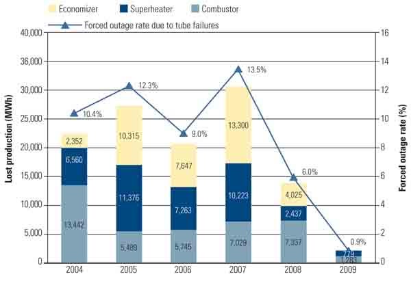

The current operating data also confirm that the plant’s forced outage rate has dropped significantly, to less than 1% for 2009 year-to-date — another key operating metric that is vital for the plant to continue to meets its projected pro forma (Figure 4).
4.    Lost money. Forced outages, principally caused by boiler tube leaks, had reduced electricity production below the owners’ expectations for many years. After investing in a comprehensive boiler upgrade project in early 2008, the improved plant performance is paying dividends in much-reduced lost production and a miniscule 0.9% forced outage rate in 2009. Source: Constellation Energy
A key point: Boiler tube wastage is also a function of the quantity of wood fuel consumed (and therefore the gas velocity), so increasing thermal efficiency reduces boiler maintenance as well as fuel cost. For example, the plant experienced 20 boiler tube leak "events" in 2005 and 25 in 2007, prior to the boiler upgrades. By mid-October 2009, Rocklin had experienced only two tube leaks all year.
