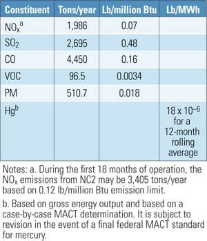

Table 5.    Nebraska City Station Unit 2 emissions limits. Source: OPPD
