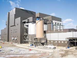

The new plant incorporates state-of-the-art emission controls, including an Alstom spray dryer absorber and pulse jet fabric filter baghouse; an IHI selective catalytic reduction system (SCR); and fly ash – and bottom ash – handling systems (Figure 2). In the order of treatment, these are the components:
  • High-efficiency burners. Low-NOx burners limit emissions by carefully mixing and combusting the pulverized coal supplied by the mills.
  • SCR system. The SCR system injects an anhydrous ammonia solution into the flue gas stream as the gas comes into contact with a catalyst, causing a chemical reaction that removes NOx.
  • Spray dryer absorber. Although OPPD uses low-sulfur coal, the scrubber uses a pebble-lime slurry to further minimize sulfur dioxide from the flue gas.
  • Powder-activated carbon-injection system. The mercury removal system removes the trace amounts of mercury found in flue gas by injecting a very finely ground powder-activated carbon into the exhaust gas prior to the spray dryer absorber.
  • Particulate baghouse. The baghouse collects fly ash. This ash is transferred to and stored on site in a specially designed landfill.
  • Monitoring station. A continuous emission-monitoring system measures the concentration of different stack gas constituents, including CO2, in the flue gas that exits the exhaust stack. NC2’s emissions limits are summarized in Table 5.
2.    All the right steps.  NCS2 uses an SCR followed by a spray dry absorber and a baghouse to keep the plant’s emissions within its permit limits. Courtesy: OPPD
