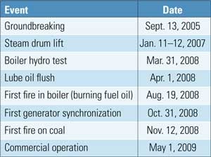

The EPC contract included various liquidated damage clauses for failing to meet key contract performance goals, but with the stick comes the carrot. Bonuses were paid to NCPP for exceeding the plant guaranteed output and for keeping the heat rate low. NCPP broke ground for the facility in September 2005; the construction completion date was set for May 2009 and was met by NCPP (Table 4).
Table 4.    Key Nebraska City Station Unit 2 project milestones. Source: OPPD
