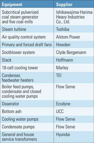

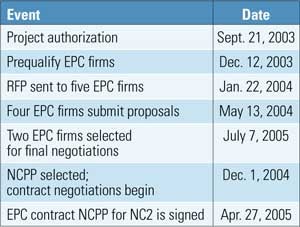

The EPC contract was awarded to NCPP, short for Nebraska City Power Partners, after a comprehensive and rather lengthy selection process (Table 2). The initial project schedule was established early in the process, and the OPPD NC2 team was able to keep the project on schedule; every major milestone was met on time or early. The NCPP team included the well-respected and highly experienced team of Black & Veatch, Gilbert Industrial Corp. (a wholly owned subsidiary of Kiewit Construction Group Inc.), and Zachry Industrial Inc. The key equipment suppliers selected by NCPP are listed in Table 3. By the end of the project, NCPP had issued a total of 228 separate procurement contracts. A significant contributor to the success of the project was the cooperative EPC approach that the OPPD team promoted and NCPP fully embraced. At every significant decision milestone, NCPP allowed the OPPD team to provide input and feedback, which resulted in a very satisfied customer and a great product.
Table 2.    Selecting the right EPC contractor takes time. Source: OPPD
Table 3.    Key vendors for OPPD’s Nebraska City Station Unit 2 project. Source: OPPD
