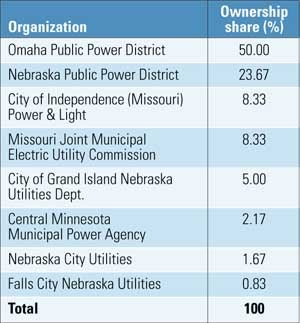

Under a participation power agreement (PPA) with the seven other public utilities, OPPD owns and operates NC2. The PPA required project participants to buy into the project by contracting for the supply of a specific amount of power and paying for the proportionate amount of the plant’s construction cost. Since the plant achieved commercial service, the other participants have purchased electricity from OPPD at the wholesale price or OPPD’s cost to produce the electricity (Table 1).
Table 1.    Participants in Nebraska City Unit 2. Source: OPPD
