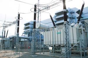

Usually, passersby can detect a power plant site by the steel pylons supporting the high-tension cables that connect it to the grid. But the utility did not want this standard, high-visibility profile. Therefore, the contractor had to connect the plant to the grid by laying underground high-voltage (400 kV) cable for 1.5 km to link it to the national grid at the Terna substation (Figure 3).
3. Stepping up voltage. These are the medium-voltage transformers installed at the Livorno Ferraris power plant. During construction, Siemens had to lay 1.5 kilometers of underground 400-kV high-voltage cable from the plant to the Terna substation in order to connect the plant to the Italian national grid. Courtesy: E.ON
