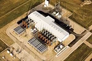

Burns & McDonnell engineers were charged with designing a plant that would provide capacity and black-start capabilities to help support MWE’s 325-MW total system demand and backup power supply in the event of a transmission outage (Figure 1).
1. Great Plains plant. Midwest Energy Inc.’s 76-MW Goodman Energy Center provides peak load capacity and system reliability support for central Kansas. The plant entered service during the summer of 2008. Courtesy: Burns & McDonnell
