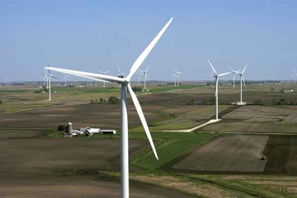

2.    Tractors and turbines.
These turbines provide additional income for some 300 owners of the land where Phases I and II of the Fowler Ridge Wind Farm are situated and have minimal impact on existing farming operations. Courtesy: Dominion and BP Wind Energy
