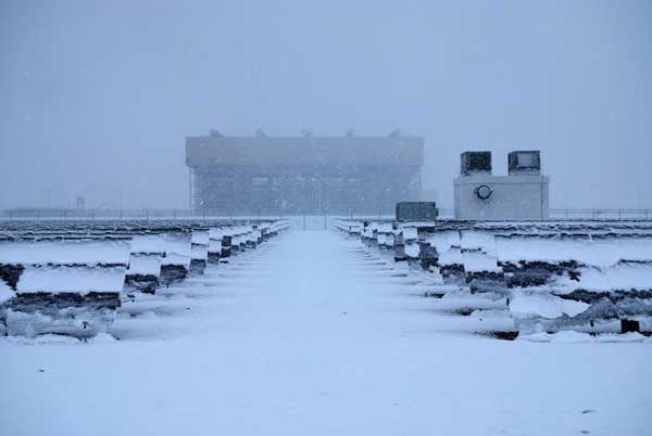

4.    Weather-challenged. During the winter months, the PV systems have little sunlight with which to make electricity. To the right is one of the plant’s 10 power control stations, which contain the inverters and switchgear for enough PV panels to produce 1 MW—when the sun is shining. In the background is the air condenser for the El Dorado Energy gas-fired combined-cycle plant. Courtesy: Sempra Generation
